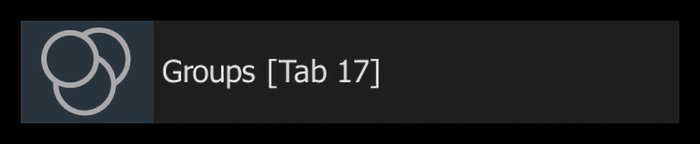

Groups [Tab 17]
The group list allows viewing and editing of groups.
Groups can be opened in a standalone tab from the Workspace Layout Menu or by using [Tab] & [1][7].
